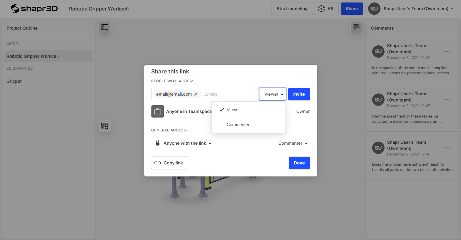

You can control who can view or comment on your Review Link by managing access permissions. Use the Share button to invite users, assign roles, adjust access settings, or copy the link as needed.
Invite users to view a Review Link
You can invite specific users to access your Review Link without making the link public. Invited users will receive an email with a link to view the project. If they don’t have a Shapr3D account, they’ll need to sign up before accessing the Review Link.
To invite a new user:
  1. Select Share.
  2. In the Emails field under People with access, enter the email address(es) of the person/people you want to invite.
  3. From the dropdown beside, select their role:
    • Viewer – Can view the project but cannot comment.
    • Commenter – Can view and leave comments.
  4. Select Invite.
  5. To save the changes, select Done.
Manage Review Link access
You can control who can view or comment on your Review Link by adjusting General access settings. Choose between allowing anyone with the link to access the project or restricting it to team members only.
To manage access settings:
  1. Select Share.
  2. Under General access, choose who can access your Review Link:
    • Anyone with the link – Grants access to anyone who has the link.
    • Members of this team – Restricts access to team members only.
  3. From the dropdown beside the selected option, choose a role:
  4. To save the changes, select Done.
