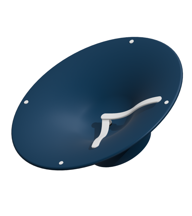

In the final part of the series, Daniel completes the wall clock by designing the clock hands, snap-fit connectors, and a clever bending mold — all optimized for 3D printing. This part gets into the practical side of designing for additive manufacturing, where print orientation, material behavior, and real-world testing all shape the final design decisions.
Tools and concepts you'll learn:
  • Offset Edge and Extrude to Object: Build a snap-fit sleeve around the clock mechanism's shaft, using precise offsets to dial in a snug press fit.
  • Chamfer and Fillet: Add a lead-in chamfer to help the sleeve go over the shaft ridge, and round all stress relief slots to avoid crack points in the printed part.
  • Subtract: Cut relief slots into the snap-fit sleeve to give the material enough flex to snap into place.
  • Project and Linked Sketch: Derive the mold geometry directly from the clock body sketch so the curvature stays consistent across parts.
  • Symmetric Extrude: Build the bending molds in both directions from a single sketch profile.
  • 3D Print Workflow: Print hands flat for maximum strength, heat them on the print bed to soften the material, and press them into the mold to form the final curve.
