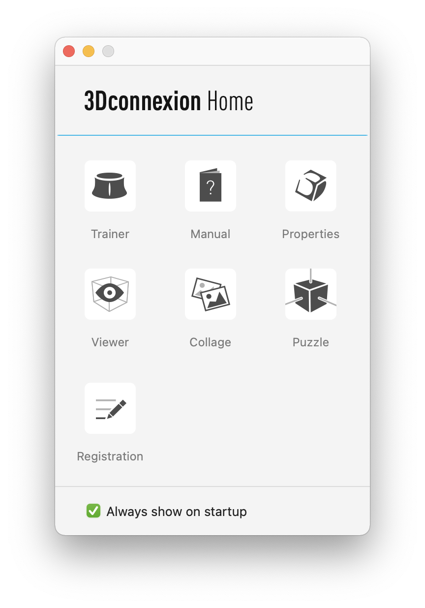

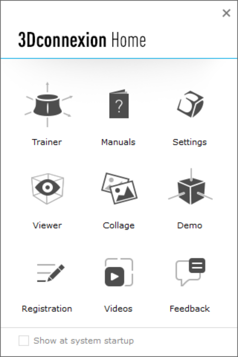

  1. Go to 3Dconnexion’s website and download the latest version of 3Dconnexion’s driver.
  2. Install the driver.
  3. Once the 3Dconnexion Home program automatically opens after installing the driver, plug your SpaceMouse into the computer via the USB cable.

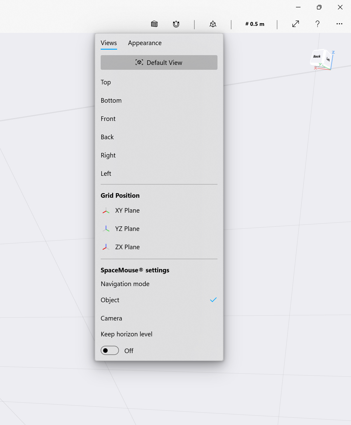

  5. Optional: While using Shapr3D, you can change the navigation mode of your SpaceMouse in the Views tab under Views and Appearance.
    Note: For more information on SpaceMouse navigation modes, refer to the SpaceMouse manual.
