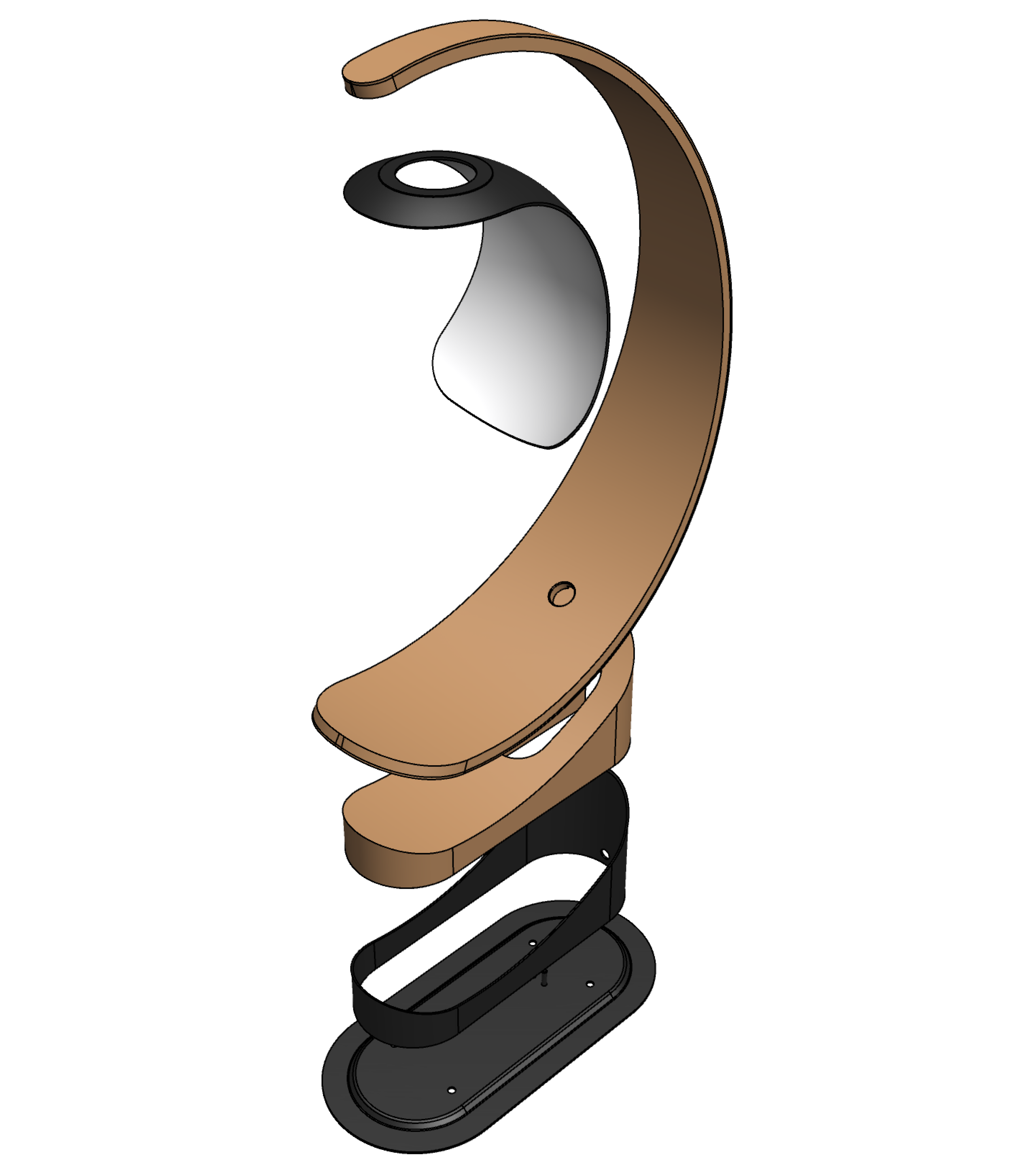

To make a die for a base plate, you’ll form a block around the base plate and use the Subtract tool to create a pocket inside of the block. Adjust design history to reorder steps and adjust additional target bodies.
Now that we've considered all of the components in this assembly for manufacturing and we've made adjustments to those pieces, it's time to make the dies and tools that are required in order to actually fabricate those pieces. Before we get started, I'm going to really quickly make a new folder here to store the parts that we previously made. And I'm just going to call this our arm. And I'm going to move this into our fabricated parts.

This part is fabricated by pressing a metal die or a plastic die into a sheet of material that then deforms that sheet into the base plate. So we're gonna make a die and then we're gonna make a template that's gonna help us finalize the shape and place all of the holes. Because we're pressing this part out of sheet metal, we're going to make a die and use a sheet of material that's larger than the finished part that we're going for. So using the

I'm going to use this sketch to help define the size of the die. And right now I'm going to select our part and I'm just going to hide this to get it out of the way. I'm going to extrude this surface upwards and just give it a 50 millimeter thickness. And I'm also going to drop this surface down here, give it an extra 20 millimeters. So for a total of 70.
02:47
And with that, I now have a block that encompasses our base plate. And what I'm going to do is subtract that base plate from the inside of this block by double clicking on our block, subtract, and then selecting our base plate. And you can see that we have a minus sign for our base plate and a plus sign for our block. I'm going to make sure that we're going to keep our removed bodies. And then I'm going to select check.
03:15
So what does that mean? We have now a pocket that's inside of this block that's representative of our base plate, and we have managed to keep the base plate as well in the overall assembly. Now that we have a pocket that's inside of this block along with our base plate, I'm gonna hide our base plate so we don't affect it at all. And I'm also going to start breaking this block down into multiple pieces so that we can fabricate the block. First thing I'm gonna do is select the block.
03:44
and I'm going to go to Split Body. I'm going to select our plane and that's going to cut our block in half. So I'm going to click Done here. So this is our first part. I'm going to move this block out of the way and you'll see that we have some witness marks here of the subtraction. And we need to get a couple more pieces out of this. So what I'm going to do here is just give
