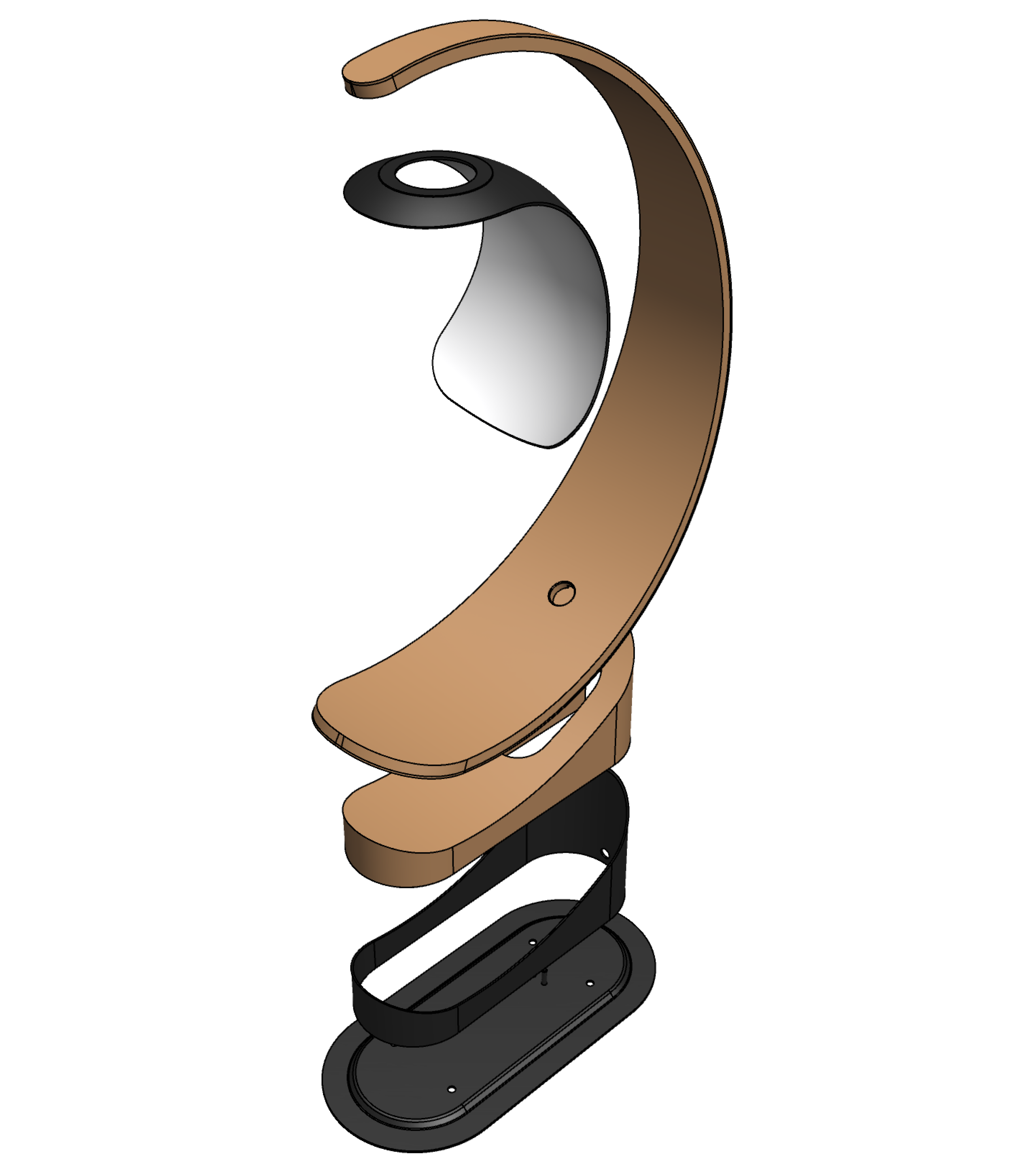

Make a template to carve out the outside shape of the lamp. You’ll extend the interior template sketch framework using parallel construction lines and offsetting them to create a basis for the outer template. Customize the offset to fit your router bit’s bearing lines and length.
So once this is completed, I actually want to make a new template that's going to help us carve out the outside shape of this lamp to the appropriate dimensions and also to cut these grooves and things into the part. So I'm going to make an exterior template now and we're going to go back to our original sketch.
