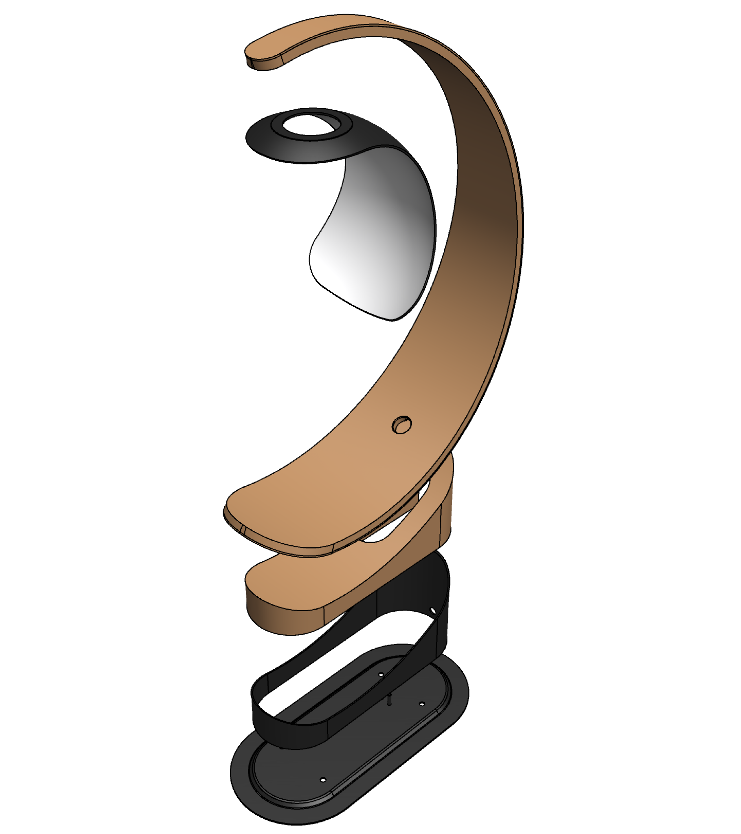

Create a trimming tool for the upper part of the lamp, including hole details. You’ll build a feature that keys into the arm c-shape with a flat surface at the bottom to fit appropriate machinery, like a drill press.

So the first thing I'm going to do here is in our side sketch, I am going to start laying out what this tool looks like, and I'm going to have it key into the shape that we cut out previously of this outer surface. And I'm going to have a flat surface on the bottom so that we could put this in something like a drill press. So I'm just going to select this edge here and draw a line across.
01:12
And I just want to make sure that I can line it up with this front edge here because the router as it comes around needs to trim that top, this front edge right here. So I'm going to click on this surface.
01:28
So as the router comes around, it's going to trim this front edge and it's not gonna interfere with the template that we're making right here. The other thing I wanna do is make sure that I can clamp this to the back part of this curve, and it's going to key into the shape that exists here already. So that gives us the basic shape. I'm gonna make sure of a couple things here. One is...

There we go. So now this allows us to complete this outer surface by trimming the rest of the lamp shape and also gives us a place to bore out the hole needed for our lamp posts.
09:09
That completes the trimming tool for the upper part of the lamp. And I can hide these.
