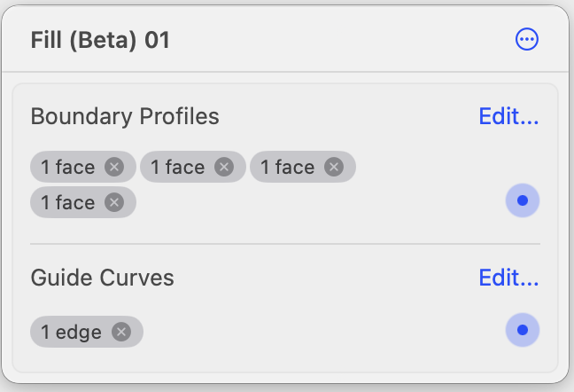

Adjust Fill parameters
While using Fill, you can open the parameter card to review or modify your selections. To open the parameter card, select Fill again from the menu.
The following parameters are available:
- Boundary Profiles – Review or modify the boundary profiles used to define the Fill geometry.
Guide Curves – Review or modify the guide curves used to control the shape of the resulting geometry.
To learn more about using and customizing the parameter card, visit Parameter Cards.

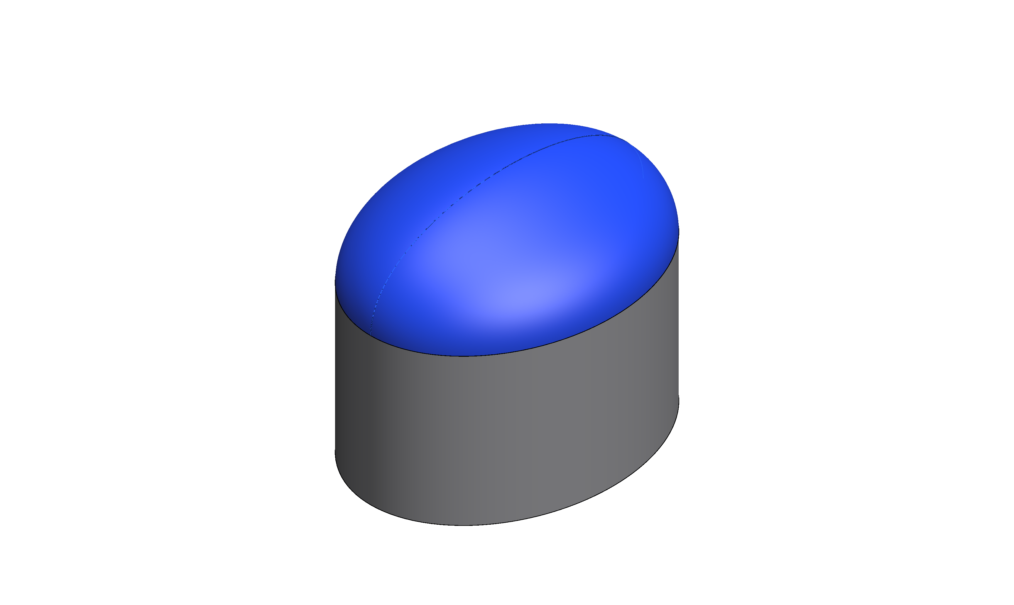

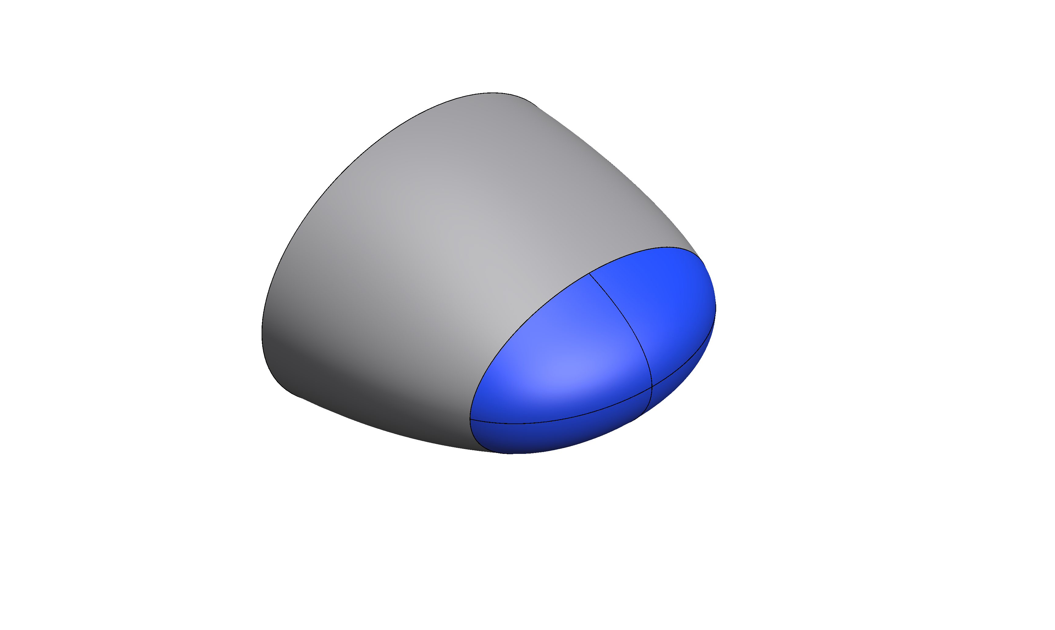

Create an elliptical dome: Use Fill to create a curved dome surface from an elliptical boundary. |
Download > | |

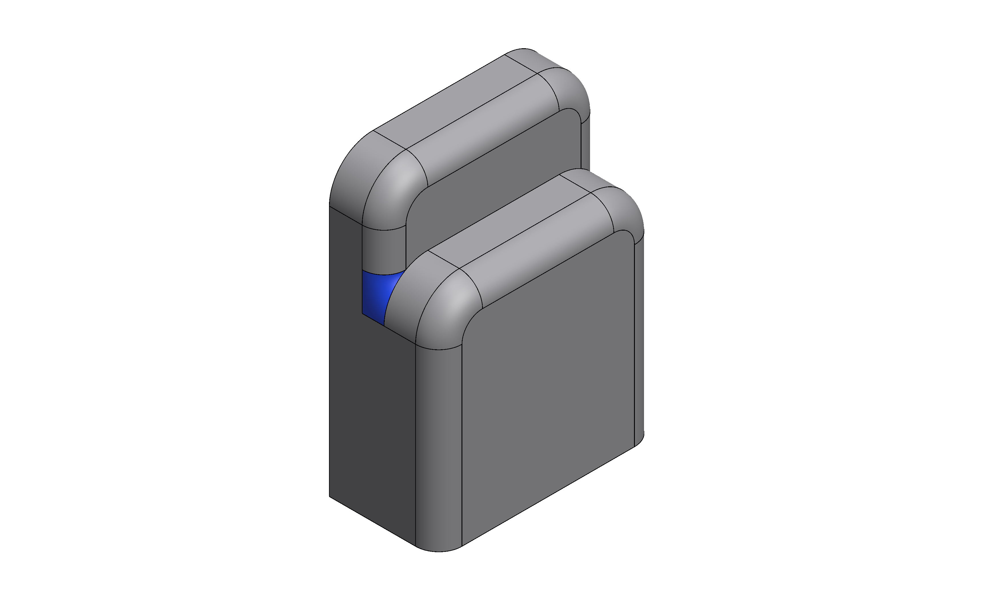

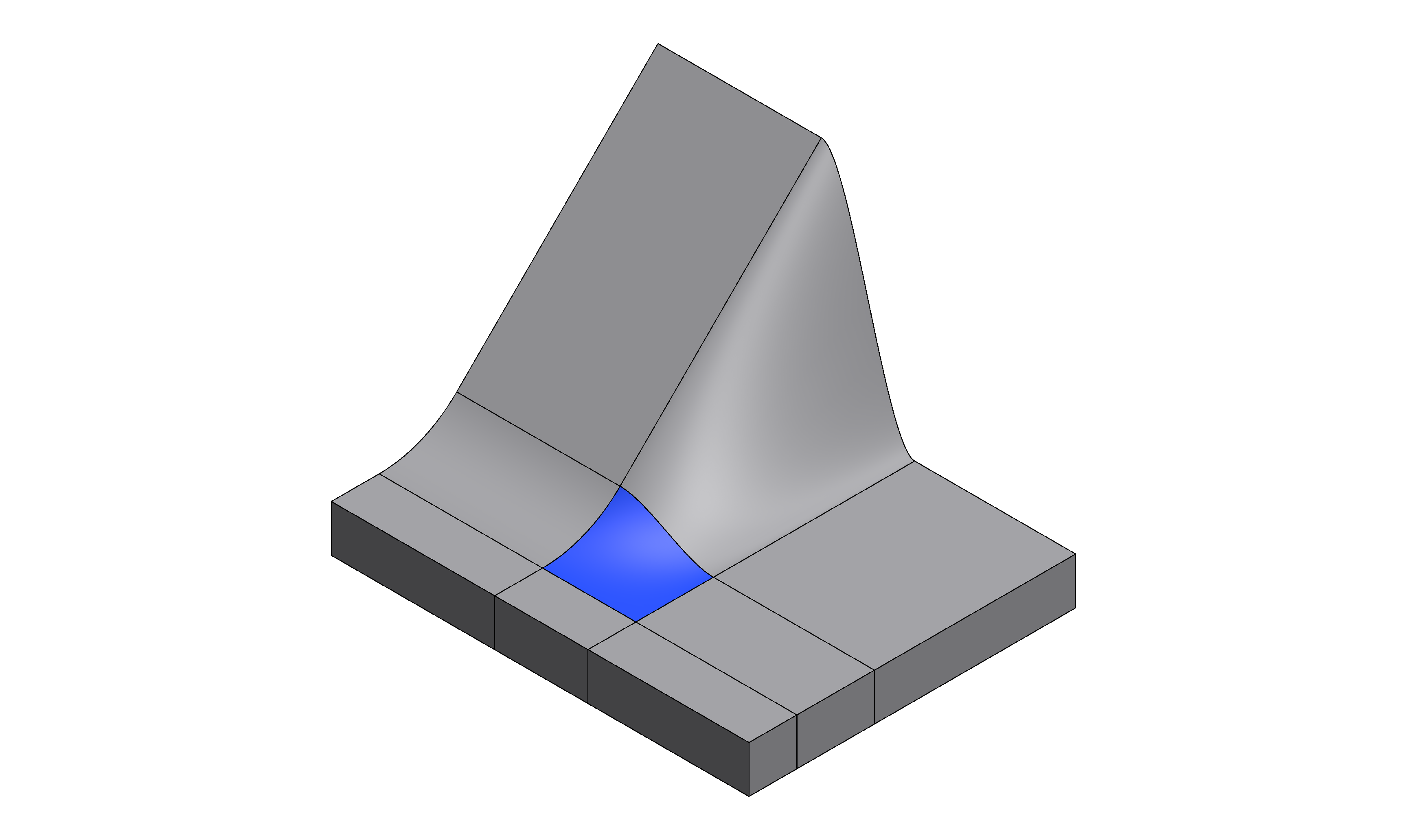

Create a smooth corner transition: Use Fill to create a smooth surface where rounded transitions meet at a corner. |
Download > | |

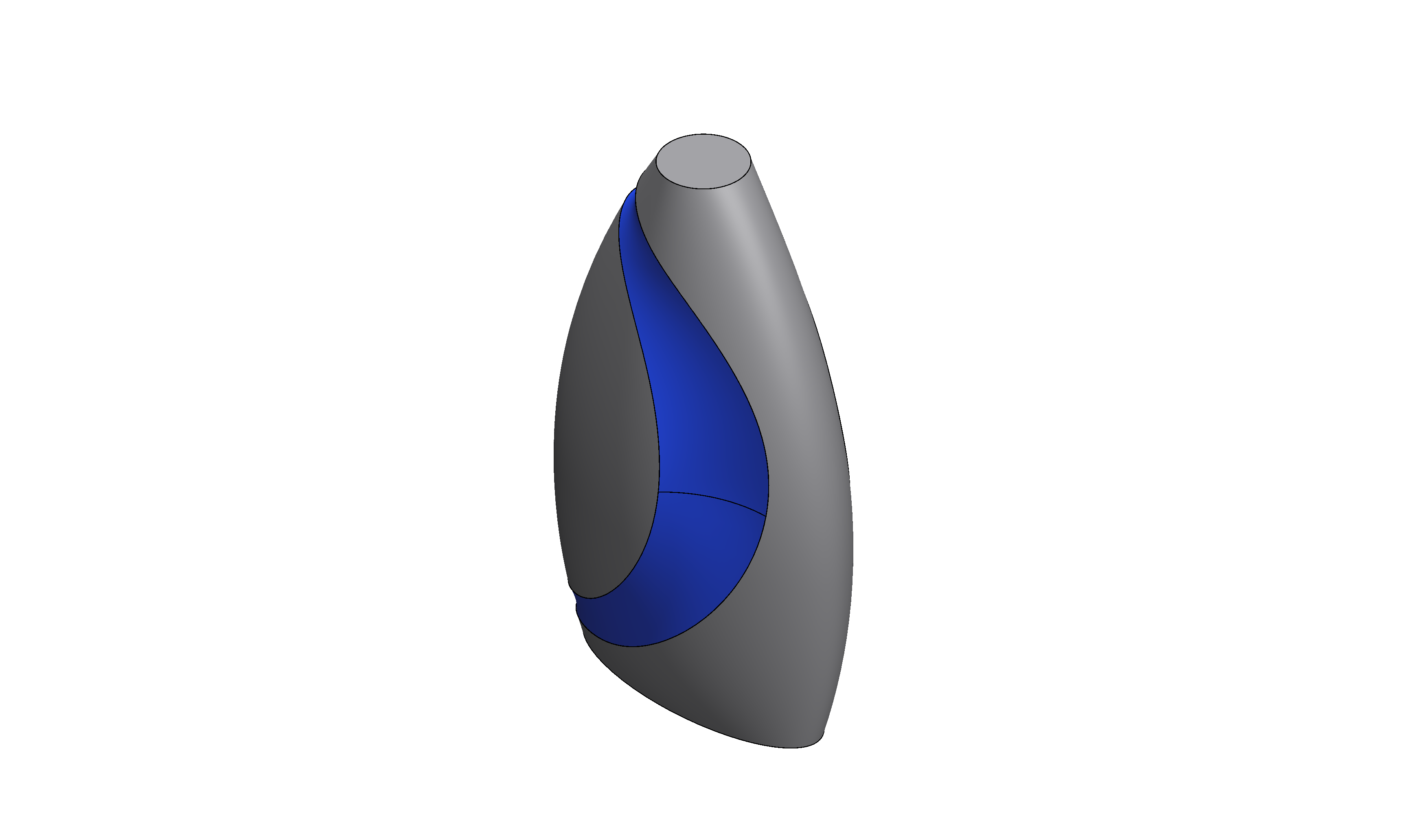

Create a soap bottle surface transition: Use Fill to connect curved boundaries and create a surface that blends into the surrounding bottle geometry. |
Download > | |
Create a curved soap bottle surface: Use Fill to create a surface across an open section of a soap bottle, following the surrounding curved geometry. |
Download > | |
Shape a soap bottle surface: Use Fill to shape a surface within the bottle's existing boundaries. |
Download > | |

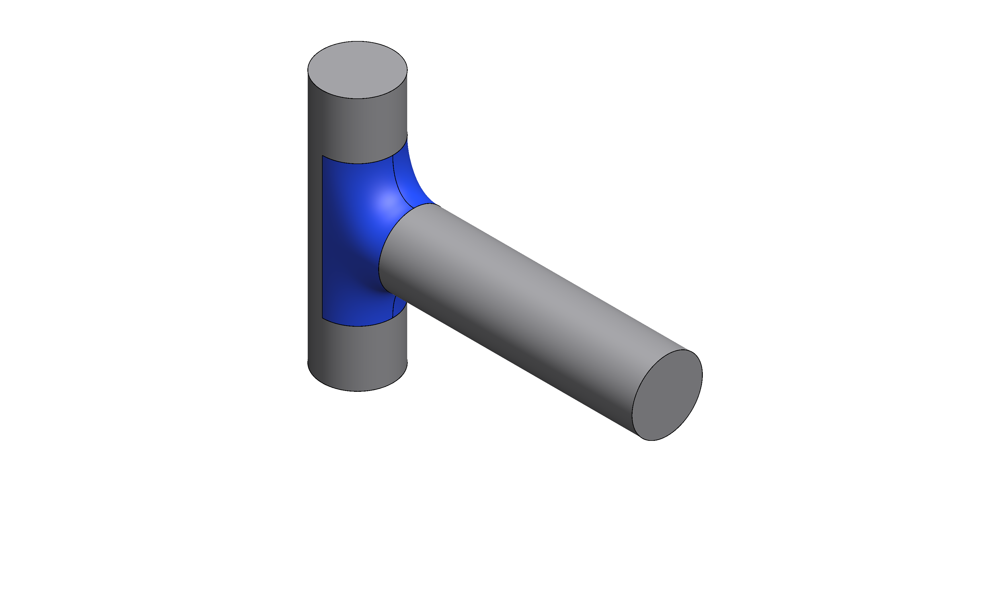

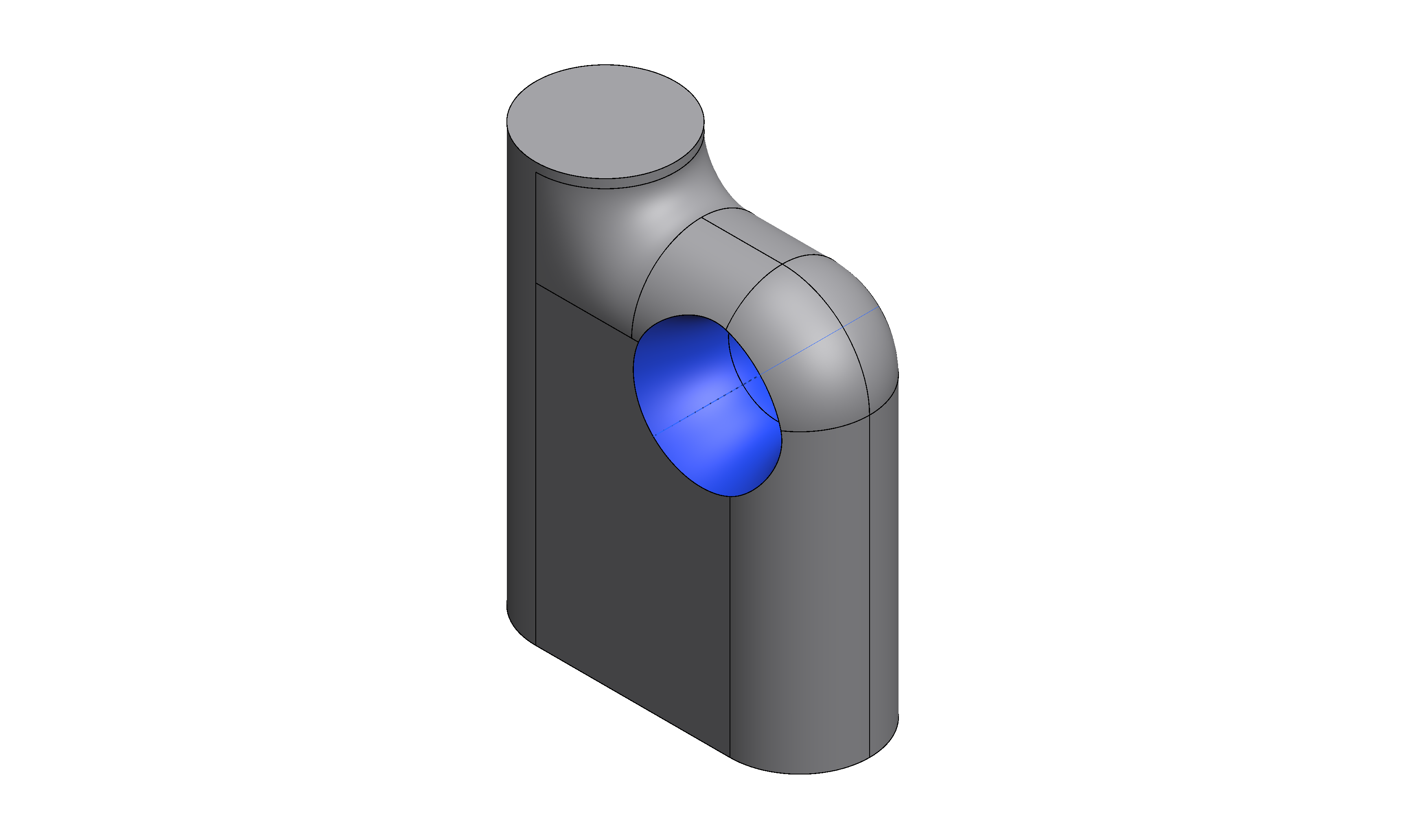

Connect two pipes: Use Fill to create a connecting surface between two pipe openings. |
Download > | |

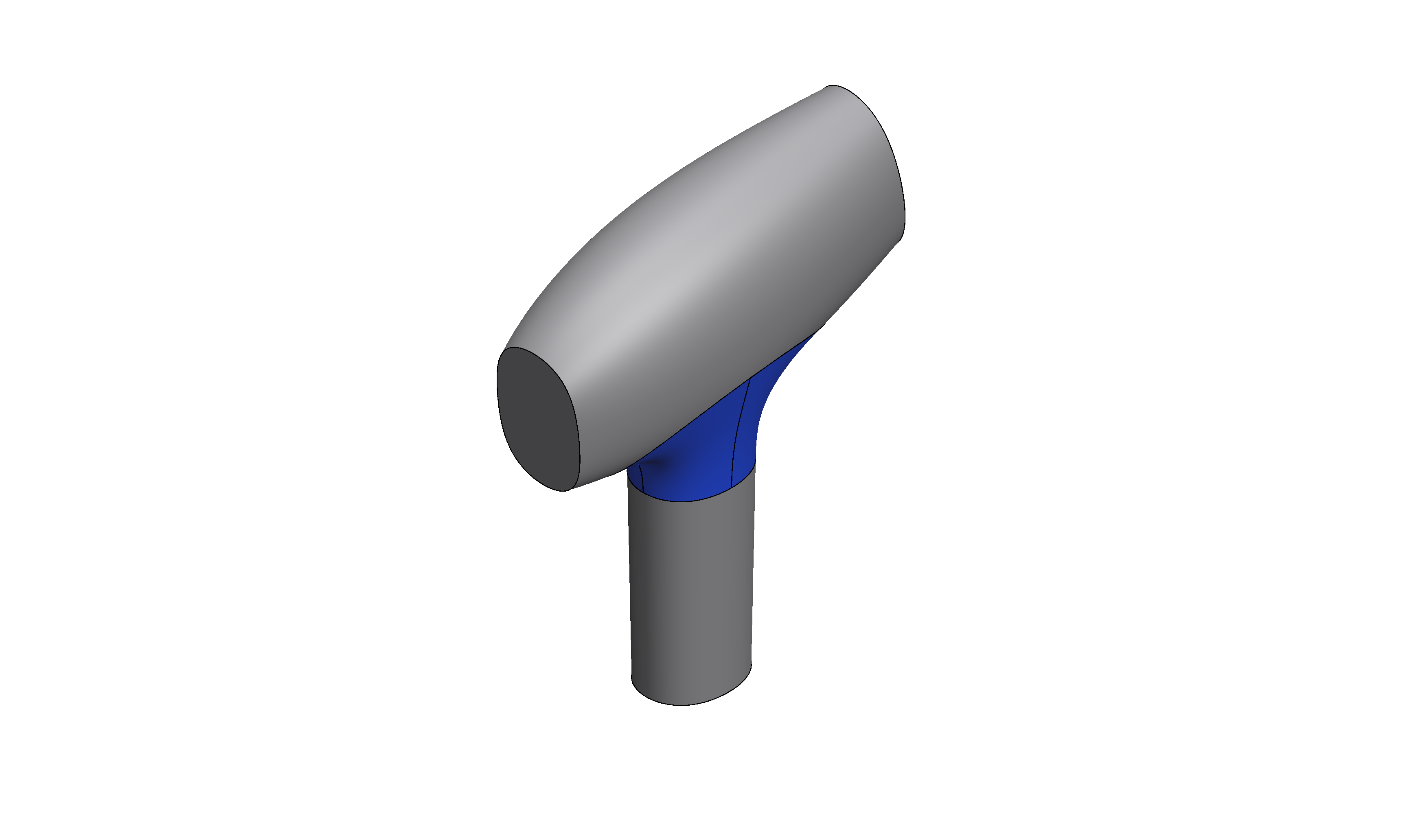

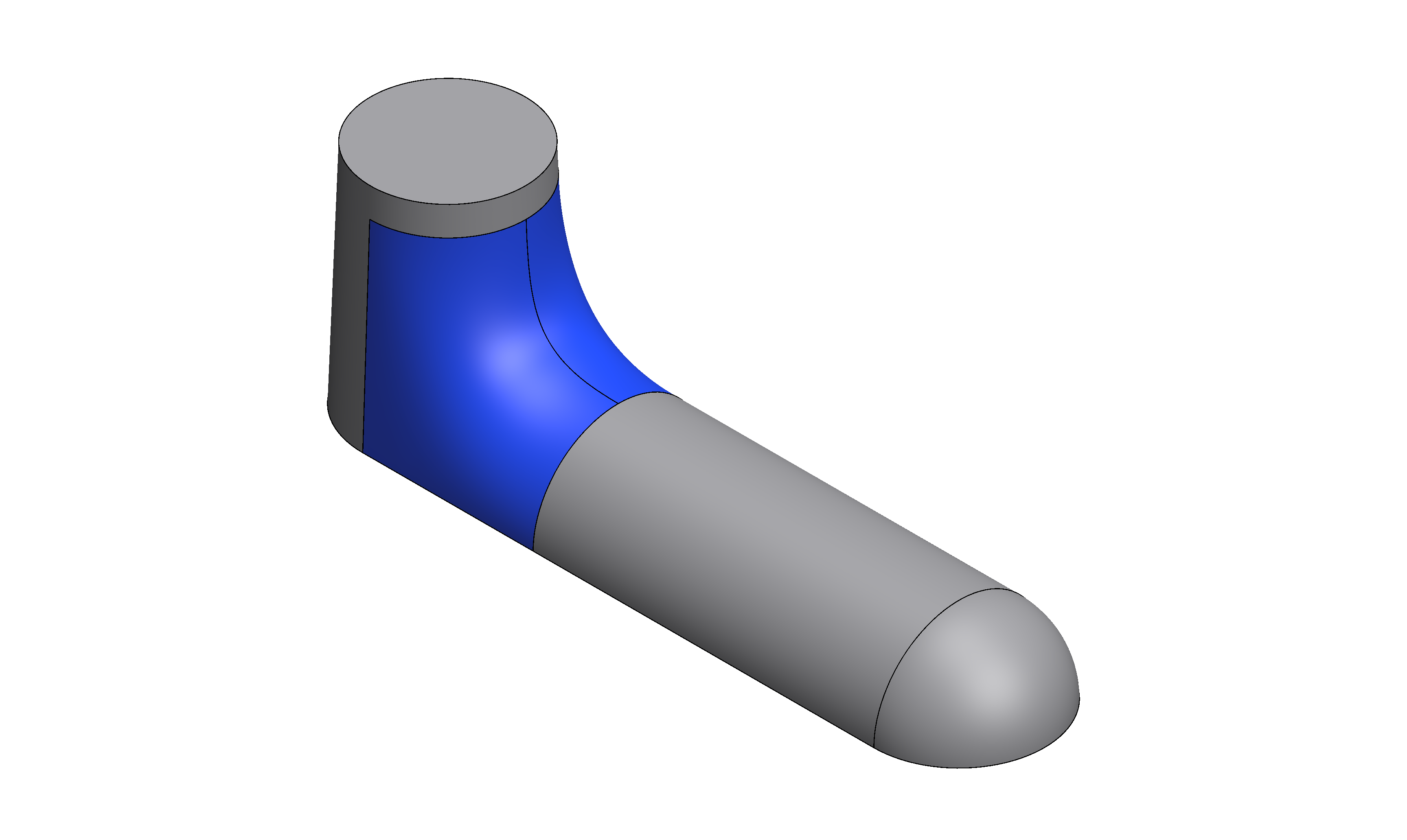

Connect a hairdryer handle: Use Fill to create a smooth surface transition between the handle and main body of a hairdryer. |
Download > | |

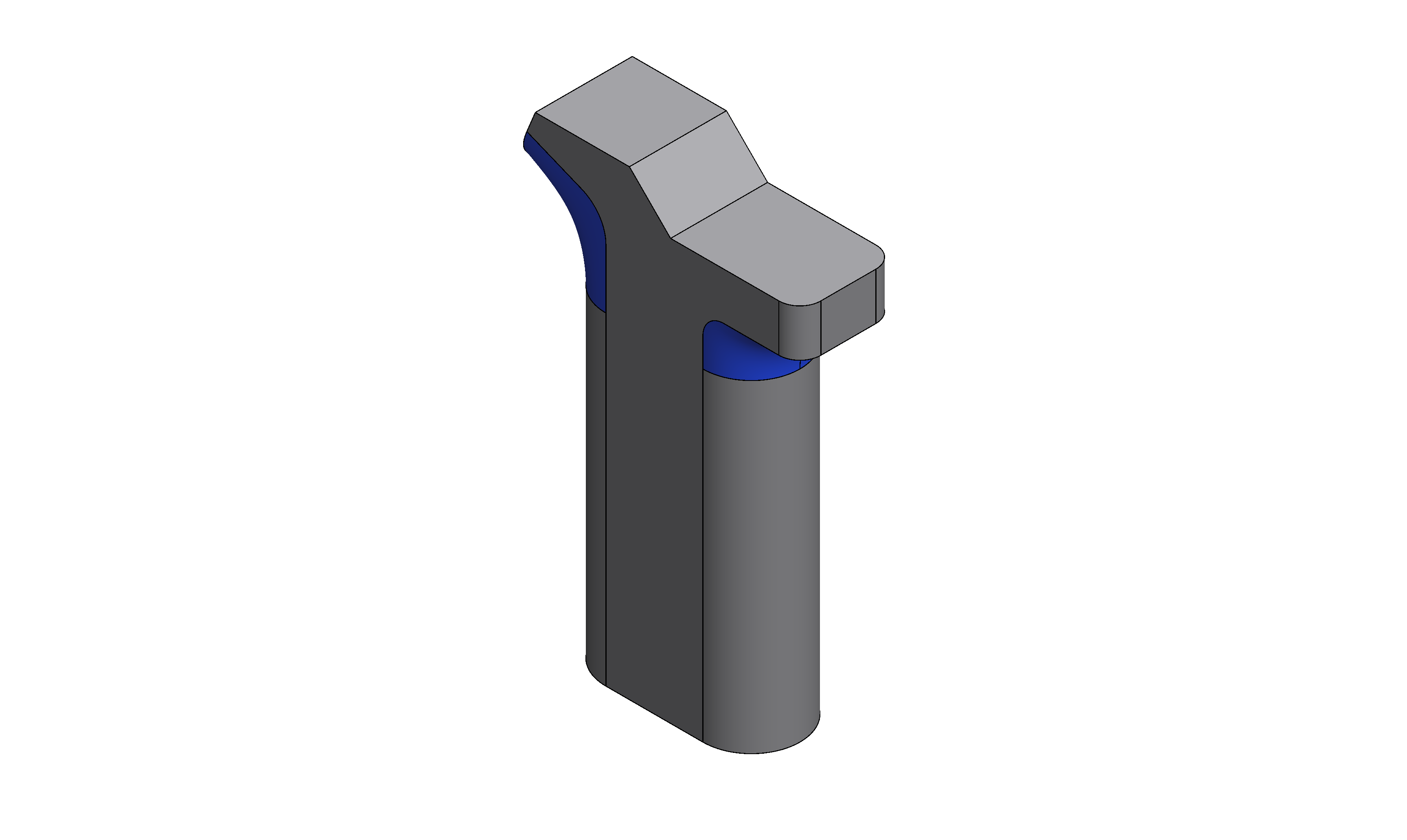

Create a smooth handle transition: Use Fill to connect curved boundaries and create a smooth surface transition on a handle. |

Connect three pipes: Use Fill to create smooth transitions between three intersecting pipes. |
Download > | |

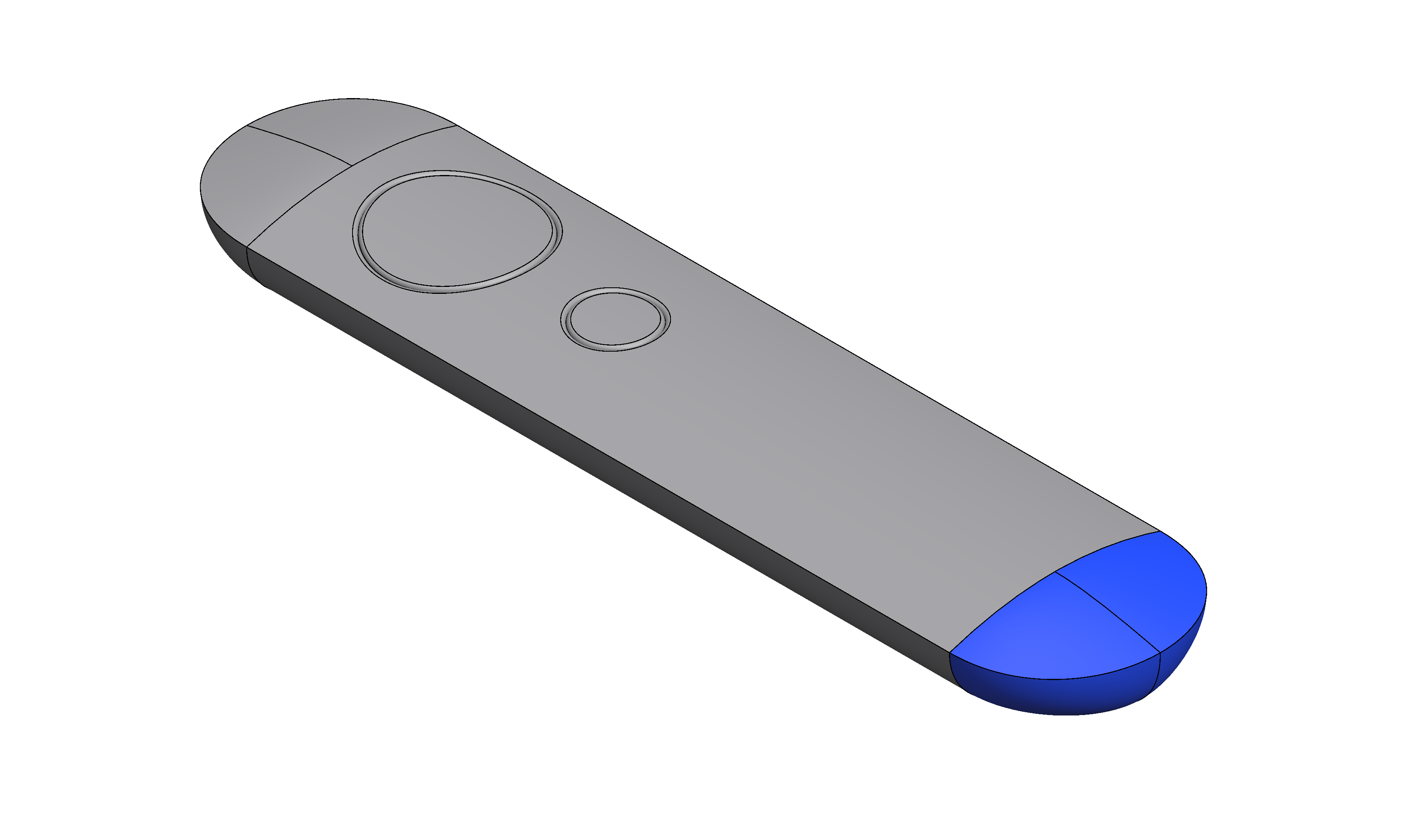

Create a rounded remote housing: Use Fill to create a curved end surface that follows the shape of a remote control housing. |
Download > | |
Create a rounded package end: Use Fill with guide curves and boundary continuity settings to shape a rounded end surface. |
Download > | |
