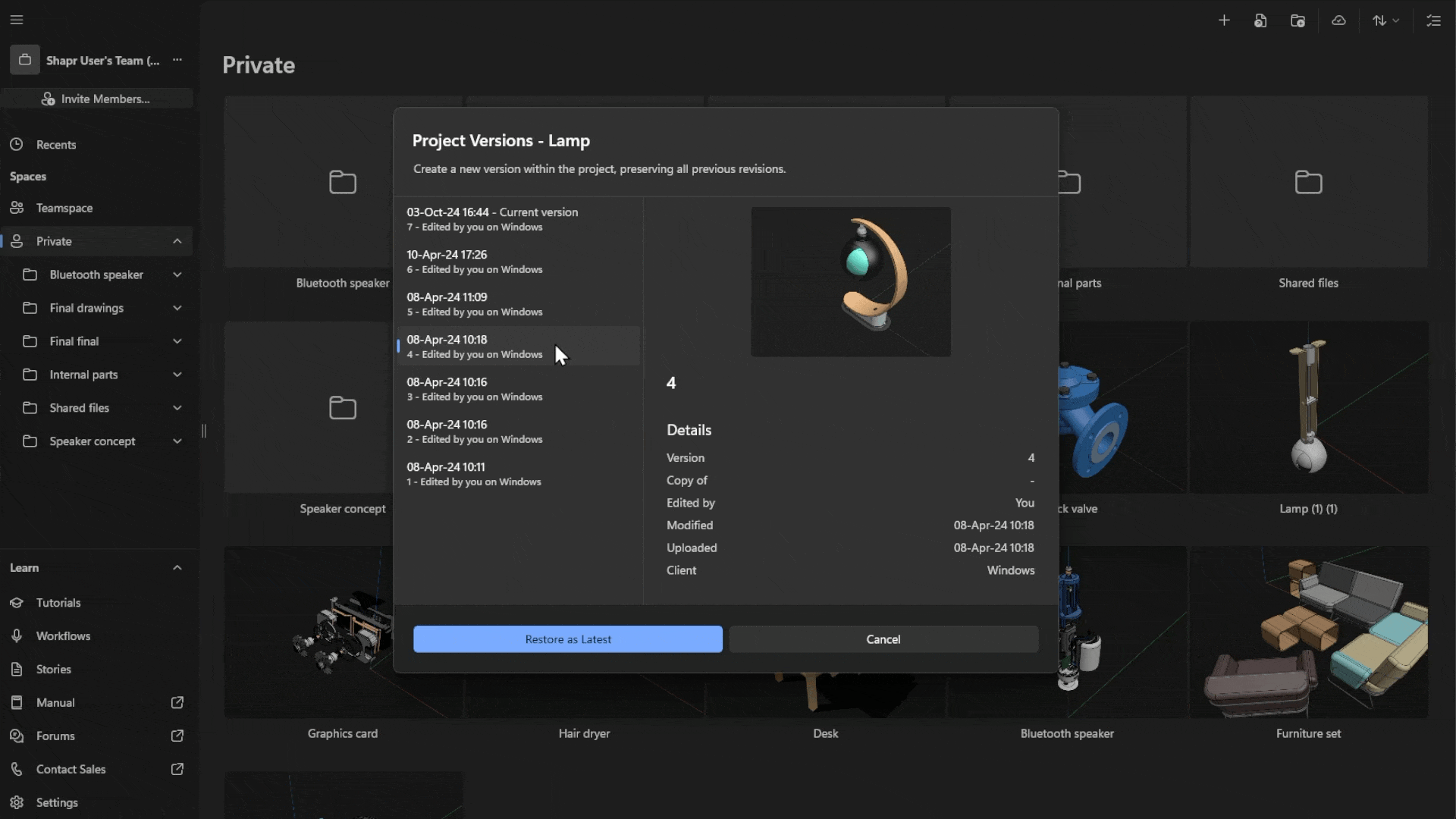

Access Project Versions

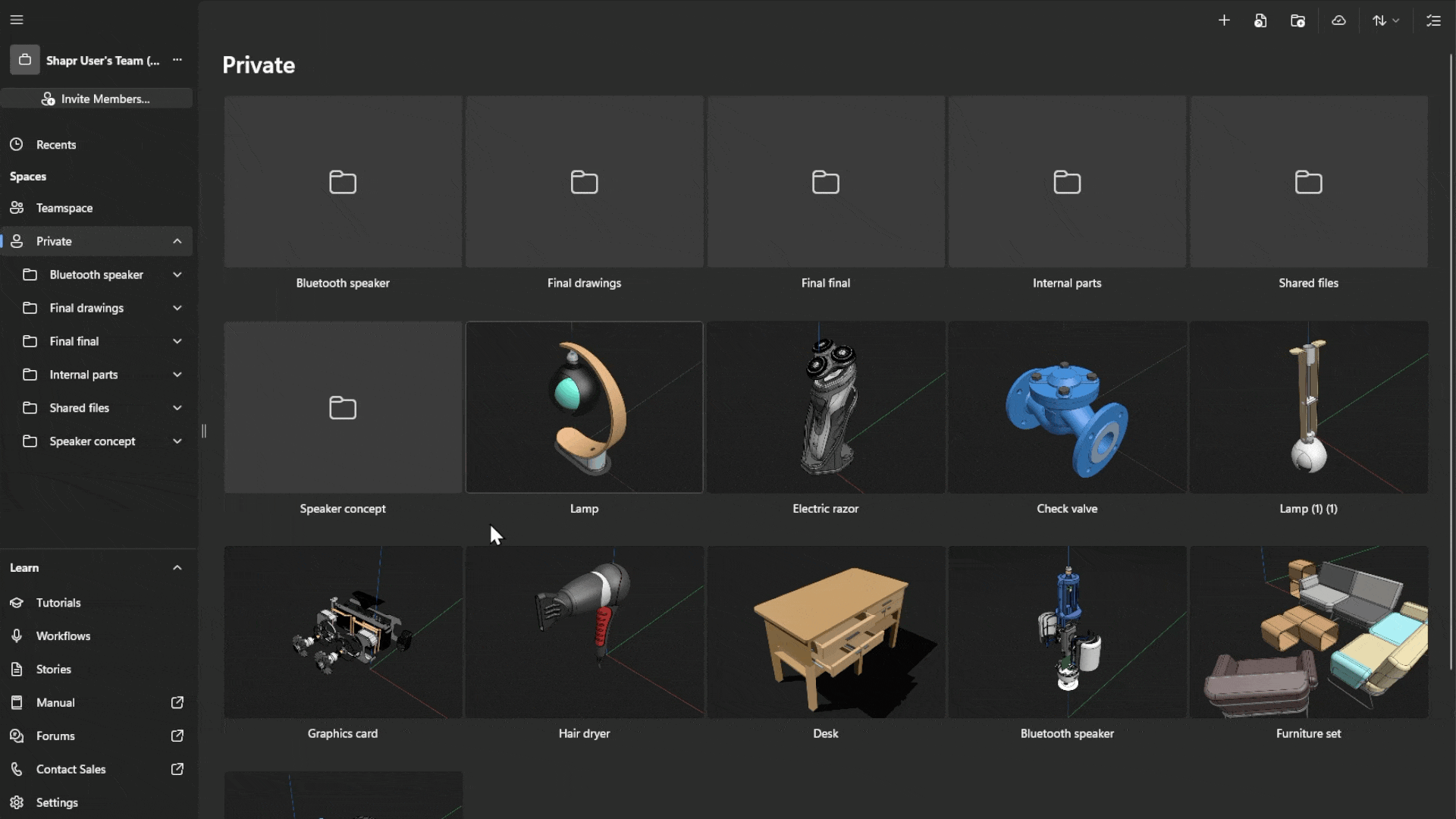

  1. Go to the Dashboard.
  2. Under the Recents or Spaces, long-tap or right-click (secondary click) on the project for which you want to access the versions.
  3. From the context menu, select Show Versions to open the Project Versions pop-up.
  4. Scroll down to browse through the available versions and check the version information in the Information section:
    • Version: The version number in the list
    • Copy of: Shows the original version number if this version was restored from a previous one
    • Edited by: The user who made changes in that version
    • Version created: The date and time the version was saved
    • Synced: Indicates if the version is synced to Shapr3D Cloud
    • Client: The device or platform where the version was created or edited
Restore to a previous version
  1. Open Project Versions for your project.
  2. Browse through the available versions and select the one you want to restore as the latest.
  3. To continue, select Restore as Latest.
