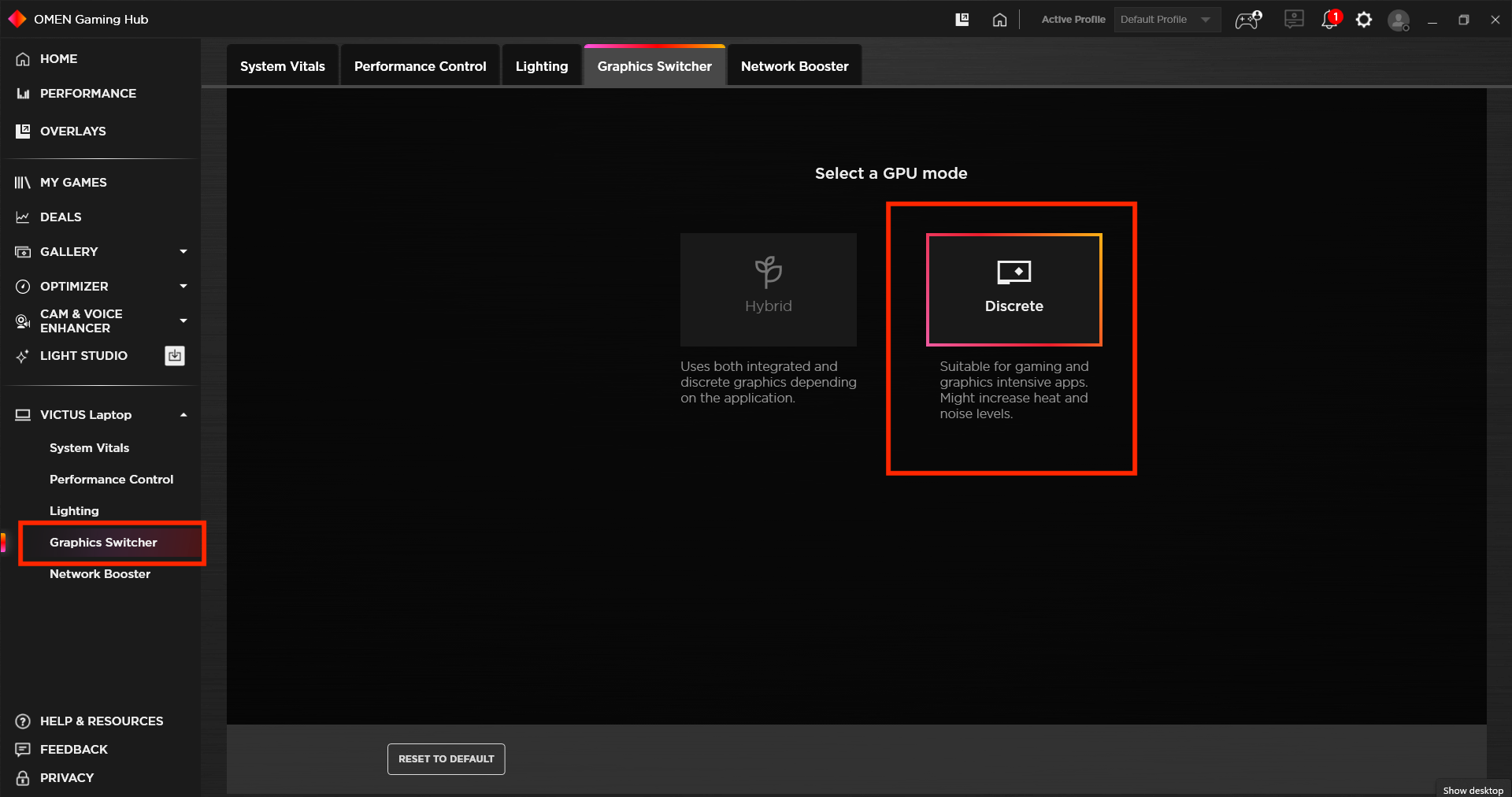

To resolve the issue, force the system to use the discrete GPU via the OMEN Gaming Hub:
Steps to enable Discrete GPU mode:
  1. Open OMEN Gaming Hub from your Start menu.
  2. Navigate to the Performance Control or Graphics Switcher section
  3. Select Discrete Graphics Mode.
  4. Restart your laptop after applying the setting.
Note: This setting ensures that the system always uses the dedicated GPU for all apps, including Shapr3D.
