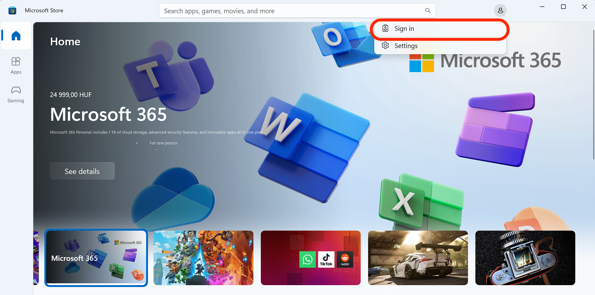

Unable to install from the Microsoft Store
Tip
You can download the standalone installer through the Shapr3D website. For more details, visit Download Shapr3D.
If you prefer to install Shapr3D from the Microsoft Store, try these tips:
