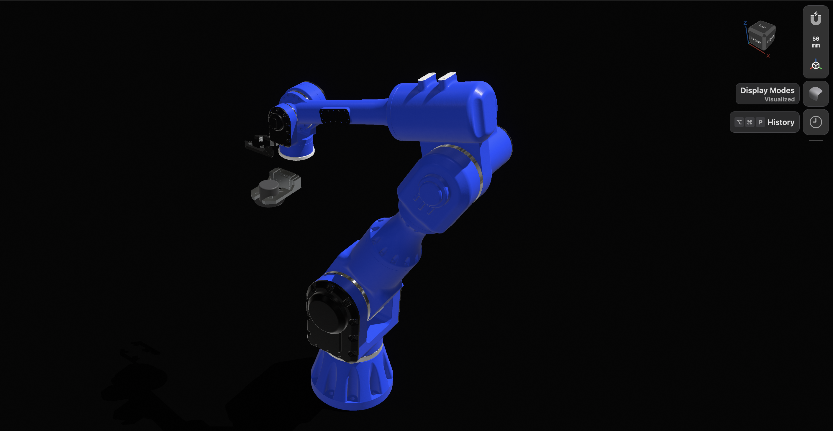

Dedicated Display Modes menu
The Shaders and Surface Analysis options have been reorganized into a dedicated Display Modes menu. You can now switch between shaders and surface analysis views more quickly, helping you focus on evaluating form, continuity, and surface quality without navigating multiple menus.
Grid and world axis visibility controls
For a cleaner modeling environment, grid lines and the world axis can now be shown or hidden from the Appearance menu. This gives you finer control over your workspace visuals especially when presenting designs, focusing on details, or working in Visualization.
Wireframe shader for clearer geometry inspection
Shaders now include a Wireframe option that displays only body edges without faces. Use it to inspect geometry and edge flow more clearly when evaluating imported parts or analyzing topology before applying operations.
