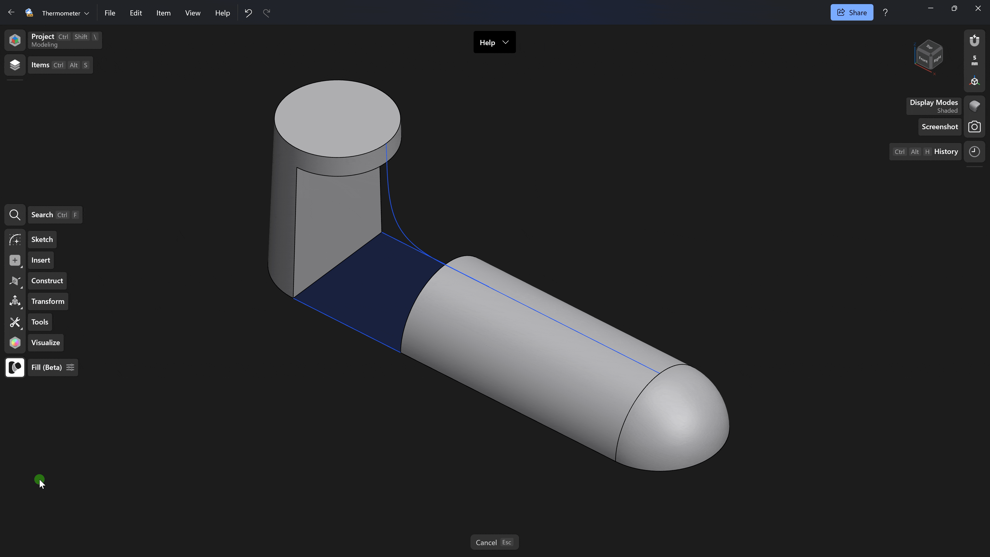

The Fill tool is now available in beta, introducing advanced surface modeling capabilities to Shapr3D:
  • Complex Surface Creation – Generate smooth solid geometry across irregular gaps, multi-sided openings, and curved transitions.
  • Flexible Inputs – Define your geometry using boundary profiles, guide curves, or connected curve networks.
  • Continuity Control – Adjust continuity settings (G0, G1, and G2) using on-screen badges to control how seamlessly surfaces blend into surrounding faces.
  • Fully Parametric – Integrated with History, keeping your surface steps completely editable at any stage of your design.
