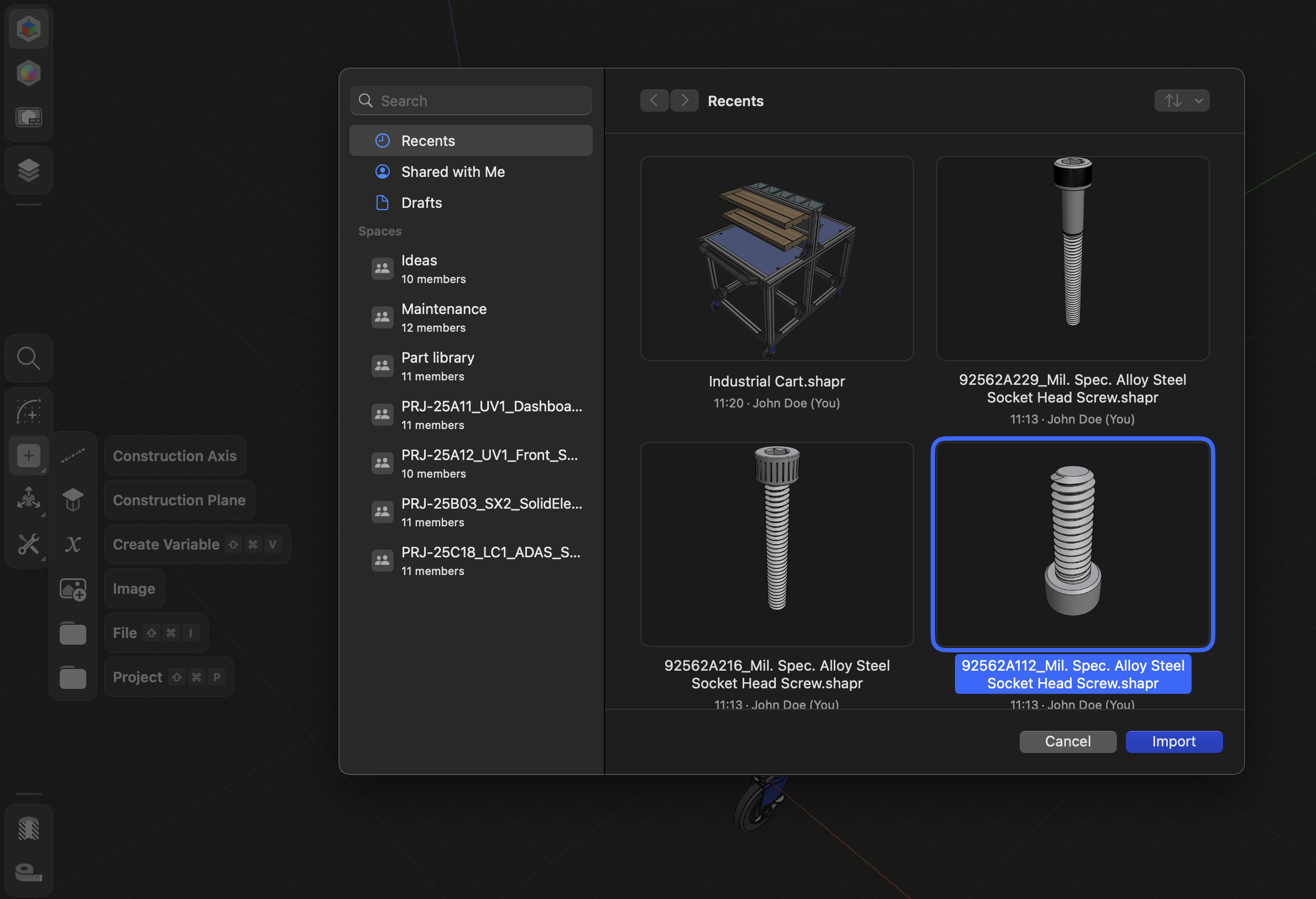

Import Shapr3D projects directly into your workspace
You can now import other Shapr3D projects into your current workspace without needing to export and reimport them first. This makes it easier to reuse existing designs, assemblies, and reference geometry across projects, saving time in iterative or collaborative workflows.
