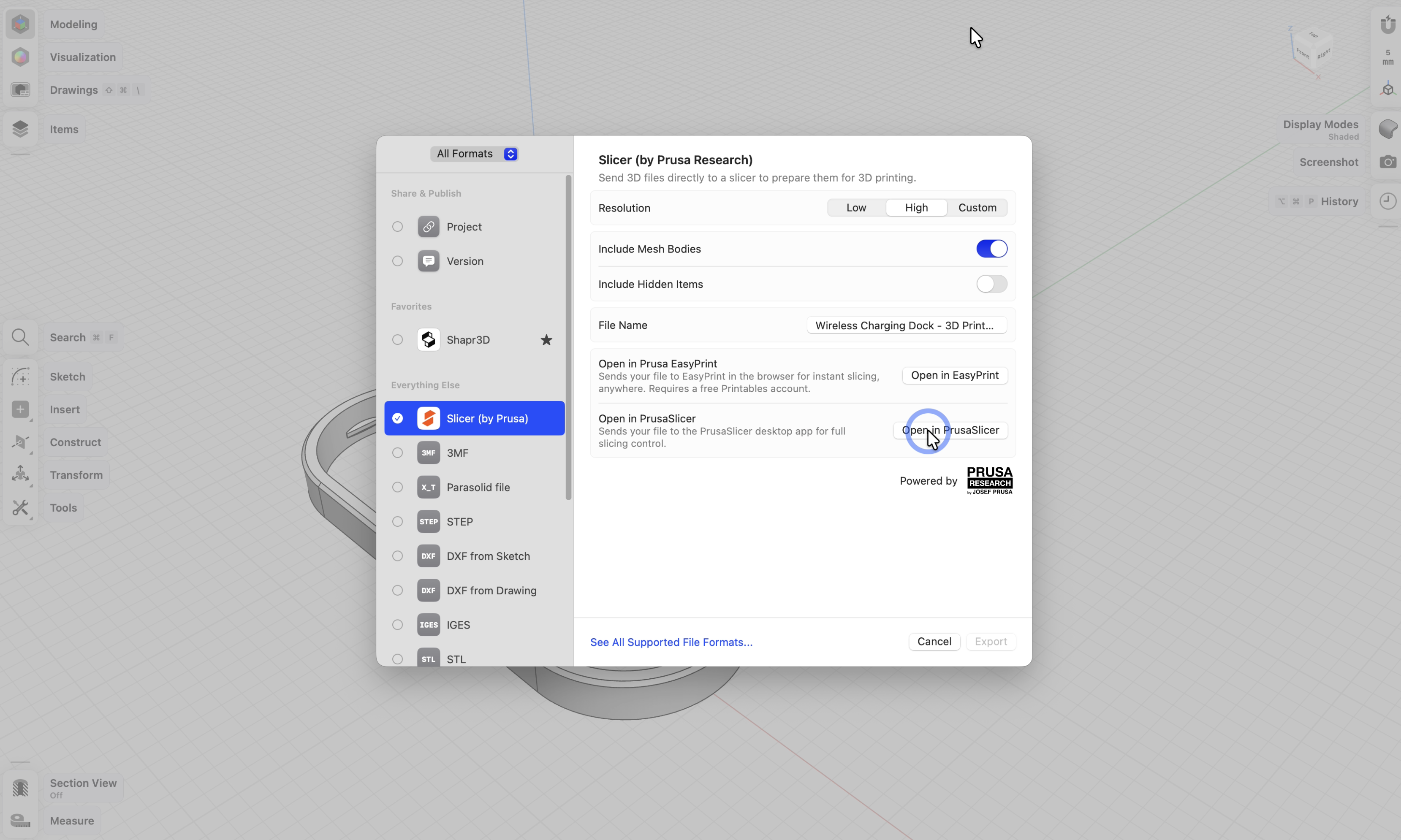

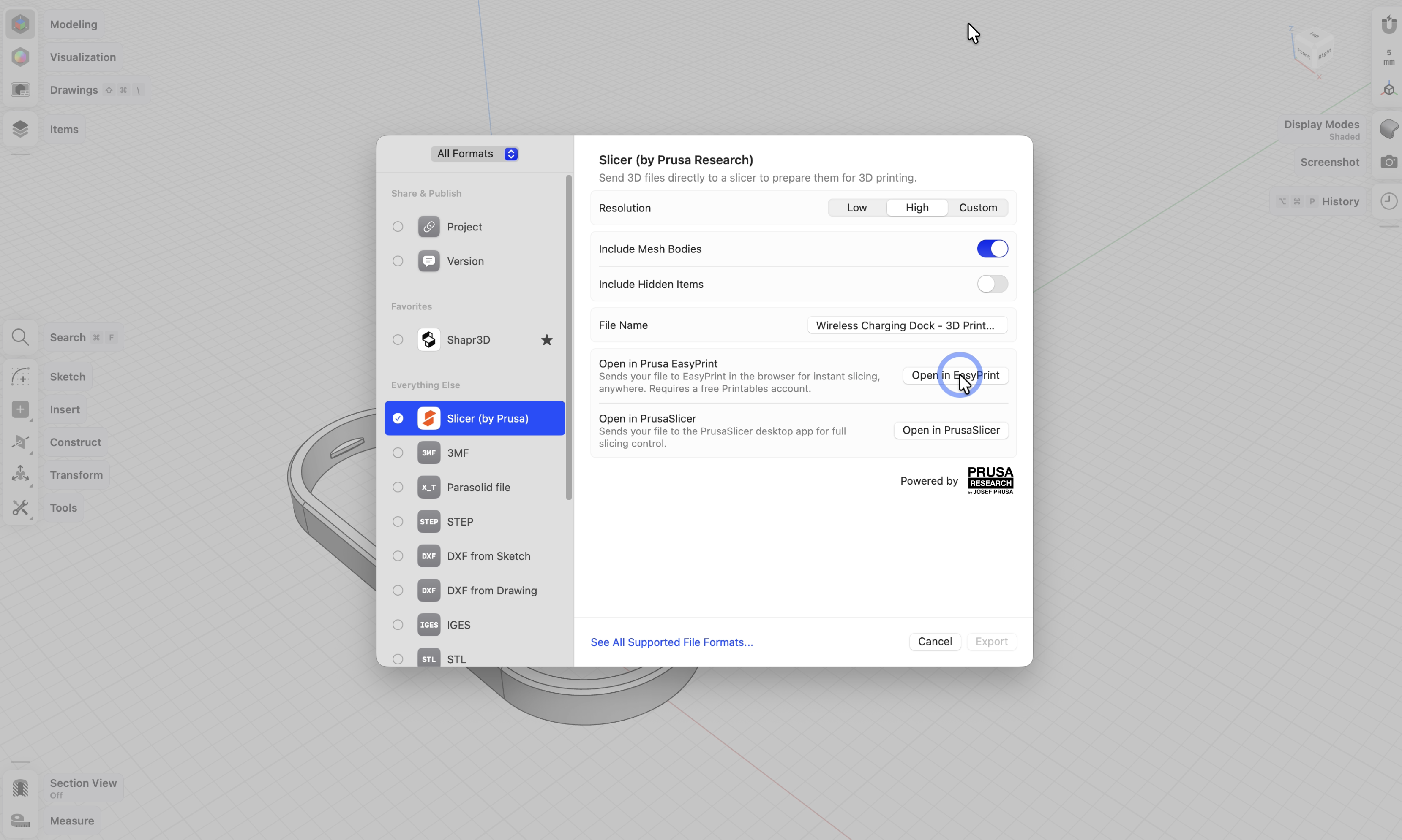

  1. Go to Export and select Slicer (Prusa) from the format list.
  2. Adjust the export settings as needed. See Slicer export settings below.
  3. Choose how to open your file:
    • Select Open in EasyPrint to send the file to Prusa EasyPrint in the browser for instant slicing.
    • Select Open in PrusaSlicer to send the file to the PrusaSlicer desktop app for full slicing control.

  • Resolution – Controls the mesh quality of the exported file. Choose from Low, High, or Custom.
  • Include Mesh Bodies – When on, mesh bodies in your design are included in the export. On by default.
  • Include Hidden Items – When turned on, hidden items in your design are included in the export. Off by default.
  • File Name – Set a custom name for the exported file. Defaults to the project name.

Prusa EasyPrint
Prusa EasyPrint is a free browser-based slicer available on Printables. No installation needed, but requires a free Printables account.
Once your Printables account is set up:
  1. Select your printer.
    Note: For first-time setup, follow the Prusa guide.
  2. Choose a material.
  3. Adjust print settings.
  4. Send directly to your printer.
PrusaSlicer
PrusaSlicer is a full-featured desktop slicer with advanced print settings and full slicing control. Best for complex prints, custom printer configurations, or when you need fine-tuned control over slicing parameters.
To use PrusaSlicer:
  1. Open your file in PrusaSlicer.
  2. Configure your printer, material, and slicing settings.
  3. Slice the model and export or send to your printer.
