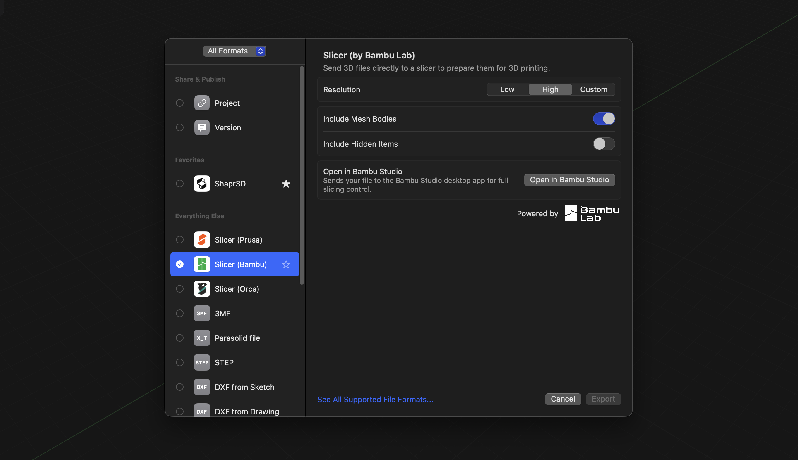

  1. Go to Export and select Slicer (Bambu) from the format list.
  2. Adjust the export settings as needed. See Slicer export settings below.
  3. Select Open in Bambu Studio to send the file to the Bambu Studio desktop app.
Before exporting, you can adjust the following settings:
  • Resolution – Controls the mesh quality of the exported file. Choose from Low, High, or Custom.
  • Include Mesh Bodies – When on, mesh bodies in your design are included in the export. On by default.
  • Include Hidden Items – When turned on, hidden items in your design are included in the export. Off by default.
  • File Name – Set a custom name for the exported file. Defaults to the project name.
