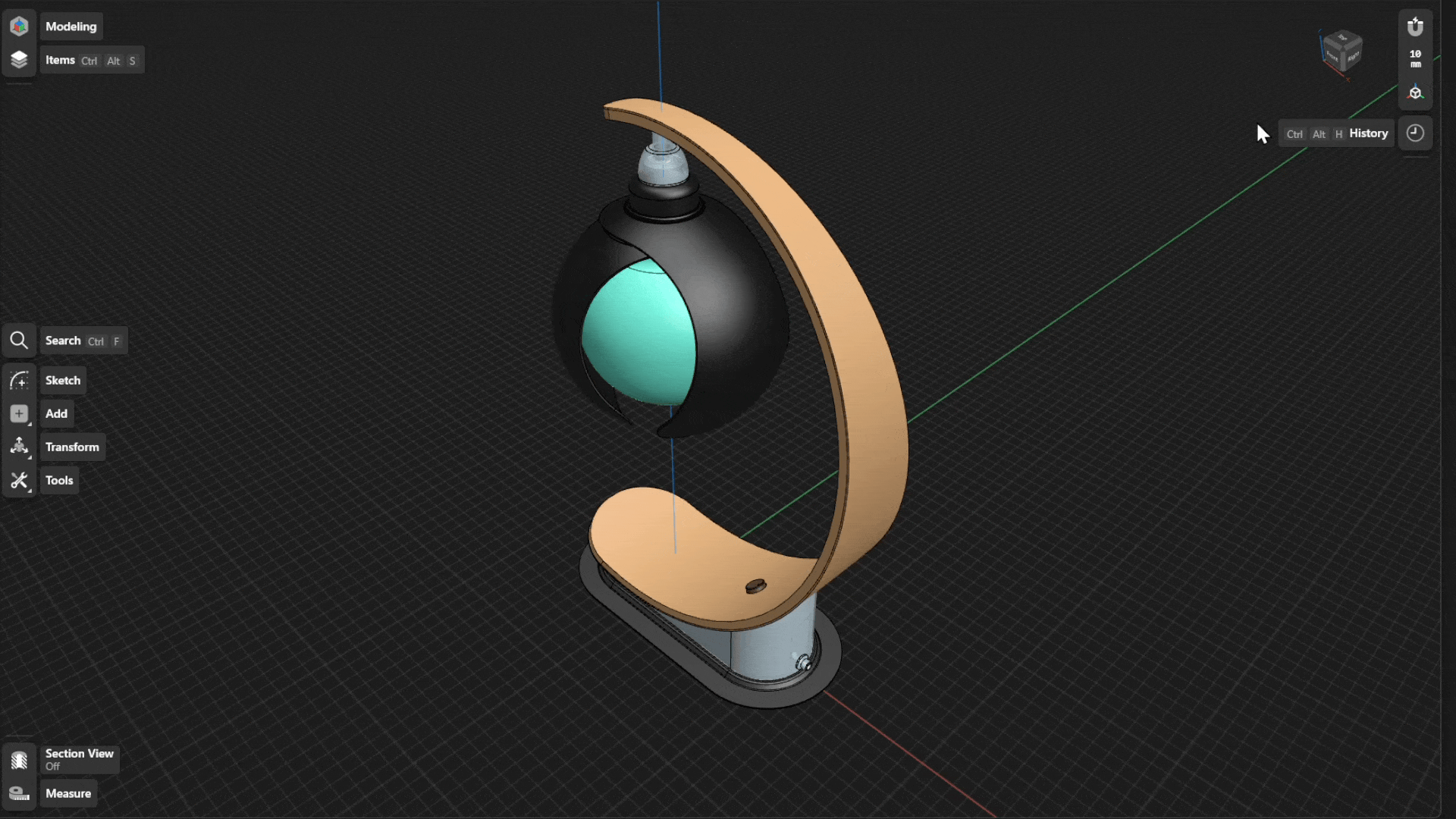

Parametric Modeling is here
The wait is over: History-Based Parametric Modeling is now out of beta. Take your models to the next level of precision with Design History.
To view or refine parameters for your steps, click or tap History.
