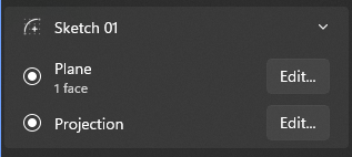

To manage history settings for the automatic Offset Edge action, find the step for your specific sketch and then view or modify the following:
  • Plane – Click/tap Edit… or Select… to modify the plane or face where you want the sketch to be and then select Done.
